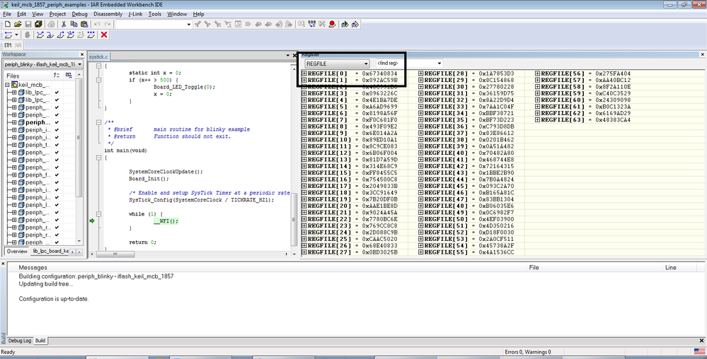

    Could you tell me which register are random value in your side?
  I have test it on my side, this is the picture from LPCopen IAR project:
  The unused register is 0, so please tell me the detail register which have random data on your side .
Jingjing
2,803 Views
daweiyou
Hi Jingjing:
it's REGFiles register:
2,803 Views
kerryzhou
Hi Dawei,

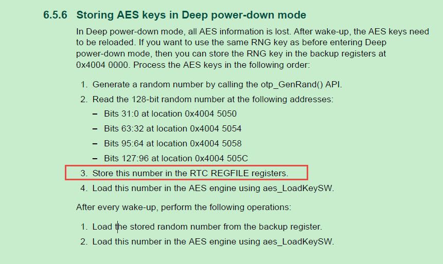

    Thank you for your more details and I can reproduce it now.
    I think the data in the MCBLPC1800 is the RNG key data, from the user manual, page96
Actually, I also tried to mass erase the chip in the MCB LPC1800 board, after power on, check 0X40041000, it still have the same data, and the chip is running the board's out factory code which may from the external flash.
  So, I think it may relate to the RNG KEY random data, but for detials, when it is wrote,  and why reset the data can't be 0, I need to contact with the AE department.
