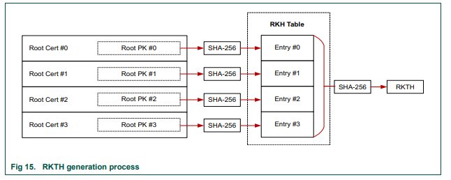

Hello all
I have some questions about cmpa and elftosb-gui tool
1. what is RKTH input in elftosb-gui->device->security tab? it is the value of ROTKH[...] in CMPA area? And how to write up to 4 ROTKH in CMPA?

The RKTH is  32 byte SHA-256 hash of SHA-256 hashes of up to four root public keys.Multiple root public keys are supported to allow for key revocation.
You may review the information on chapter 7 of the user manual for the RKTH. Please let me know if you have further qustions.

binjun-charles_
Hello Sabina
Thank you for your reply.
Now i understood it is the hash value of RKH table in signed image.
I have a further question about up to 4 certificates supported in the LPC55xx.  Assuming that i used 4 certificates which are the certificate chain. My understanding is the first one is Root certificate and then intermediate certificates, the last one is end certificate for signing image. When verifying the image, bootloader will go through all the certificates to check if image is authorized. My question is about certificate revocation. In my case, four certificates are an integral whole of trust. Any of certificates is revoked  means image will not pass verification. Is it right? And why can we select which certificate is revoked in CFPA area?.

Sabina_Bruce
Hello Charles,
Root of Trust key is a key managed by owner of key and this hash is written in PFR (like OTP). During booting ROM will authenticate certificates chain in image. 4 RoT keys are there for revocation possibility. Each RoT is also possible to revocate through serial numbers.
I believe the following two documents will help clarify the use of the above information.
LPC55Sxx Secure Boot AN12283
LPC55S69 Security Solutions for IoT AN12278
