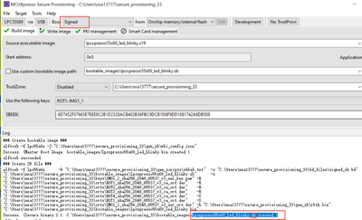

Hello @jesm86
1) The Singed image generated by MCUXpresso Secure Provisioning Software is signed+ secure, you can see the generate file is *. sb.
2) Recommend you use secure boot loader, and the tool MCUXpresso Secure Provisioning Software is used in conjunction with Secure bootloader.
