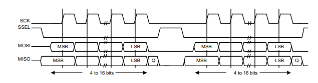

I want to SPI transfer with A/D converter.
I use SPI0 port. CPU is master. the A/D converter is slave.
the A/D converter's data frame is 32bit per frame.
So, if SSEL (slave select) is deasserted during 32 bit data transfer, the A/D converter ignores the transferred data.
So, I think 32 bit data transfer using continuous back-to-back transmissions without deassertion of the slave select.
Is there good way to transmit 32bit data from SPI0 port without deassertion of the slave select(SSEL) during 32 bit serial transmission?
Or, Is it possible to transfer the 32bit data with following way?
The way thinking currently is next:
  main register setting : CPOL = 0, CPHA = 1, DSS = 7(8bit transfer), MS = 0.
  Process:
   (1) Wait until TFE = 1 ( to output unnecessary data from transmission FIFO ).
   (2) Read the DR( data register) until RNE = 0 ( to output unnecessary data from receiver FIFO ).
   (3) SSE = 0 (to disable SPI transfer)
   (4)Write only 4 byte data into the transmission FIFO through DR ( 8bit * 4 = 32).
   (5) SSE = 1 (to enable SPI transfer)
   (6)Wait until BSY=0 ( to wait until SPI transfer is done) .

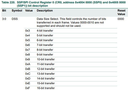

Hi Maekawa,
This MCU only supports up to 16 bit transfers, as the table 220 mention:
This will depend if the A/D converter that you're using allows gaps between frames.
