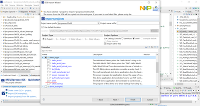

xiangjun_rong
In the SDK package, there is shell example, you can use it to communicate between PC and  the LPC so that the LPC can execute the instruction to read/write PN7160 which you send via shell and return the result to PC via uart.
But I suppose that the LPC55xx and i.mxrt117x have the shell example in SDK, it is easy for you to modify it to adapt your application. The low cost LPC82x does not have the shell example in SDK.
Hope it can help you
XiangJun Rong
2,700 Views
BruceChang
Unfortunately, we are use LPC82x....>_<
So, I need to check with LPC55xx and i.mxrt117x example in SDK and hope it is easy porting to LPC82x.
