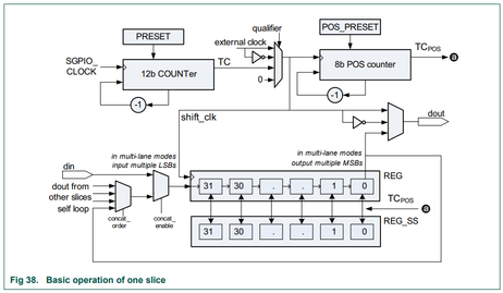

Hello NXP Support,
Is it possible to get a thorough explanation on what a qualifier is and how it is used? I checked the UM10503 datasheet and there is no concrete explanation of what a qualifier is and how to use it. This will be very much appreciated if you can provide one.

Just for double check, are you referring to the qualifier of the Chapter 18: LPC43xx Serial GPIO (SGPIO)?
LPC43xx User Manual (UM10503). Chapter 18: LPC43xx Serial GPIO (SGPIO). Section 18.7. Functional description mentions: "The shift clock can be qualified by an external pin or other slice."
[LPC43xx ARM Cortex-M4/M0 dual-core microcontroller User Manual. Chapter 18: LPC43xx Serial GPIO (SGPIO)]
If you look to Fig 38. Basic operation of one slice, you may find that the qualifier is being used to enable or disable a multiplexor of SGPIO_CLOCK signal.
Section 18.6.2. SGPIO multiplexer configuration registers (SGPIO_MUX_CFG0 to 15) mentions how to use the register to enable, disable, use a slice or an external pin as a qualifier.
