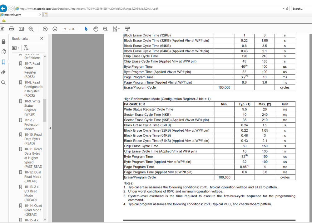

Regarding your question, as you know that the SPI flash MX25R6435FM2IL0 is used on OM13092, you can download the data sheet of the spi flash from the link:
http://www.macronix.com/Lists/Datasheet/Attachments/7428/MX25R6435F,%20Wide%20Range,%2064Mb,%20v1.4....
The erasing/programming time is dependent on the spi flash itself rather than the processor.
Pls refer to following figure, you can see that sector erase time is from 40ms to 240ms, you test the sector erasing time as 47ms, it is okay.
Hope it can help you

prasannanaik
Hi xiangjun.rong‌,
   Thanks for your help.
   The datasheet helps in understanding the 47 msec time but why am i getting 3.64 msec sector erase time when i am just testing the sector erase as mentioned in case 1 of  my query. Even that time should be 40 msec ?

xiangjun_rong
Hi, Prasanna,
I suspect you test the wrong elapsing time with GPIO timing for the flash erasing/programming time, can you use a Timer to get the accurate tick number?
