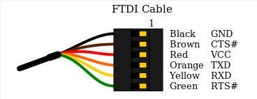

But still I am confused with the type of the USB to serial cable to be used. Can I use any FTDI cable and use only the 3 pins (TX, RX, GND) to the respective pins in the P1 connector. Some web pages suggest to use a USB to serial adapter board which performs more closely to an RS232.

I have done exactly as you say multiple times.  Use TX/RX/GND to the Serial2USB cable from FTDI successfully.
USB TTL Serial
Specific cable is:
TTL-232R-3V3
5V version of cable also works.

How do I hook up the FTDI cable to the stamp board. Could you please help me with this?

You need to read chapter/section 32.2 of the LPC176x User Manual. This will explain what happens when ISP boot mode runs.
In ISP boot mode the device will boot via UART0. The board you are using doesn't come from NXP, but a quick look at the schematic on the NGX site shows UART0 (RXD0/TXD0) is brought out to the P1 connector. You will need to connect your USB to serial there to use Flash Magic.
