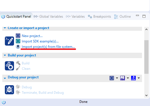

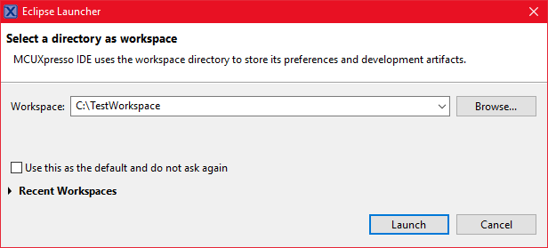

  1. Open or create a workspace:

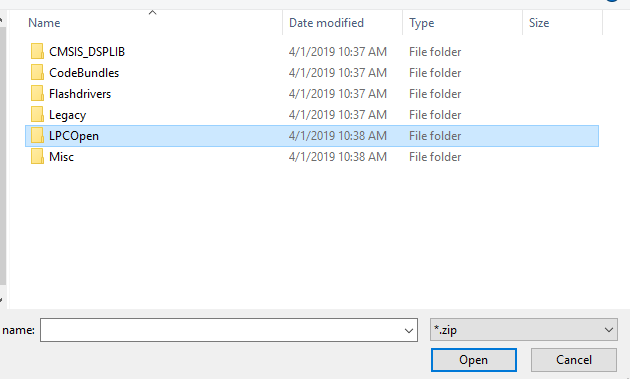

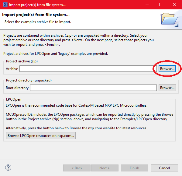

2.   Click on "Import project(s) from file system…"
   3.   A window like this will open, click on the browse button, open the LPCOpen folder, and select the lpcopen_2_10_lpcxpresso_nxp_lpcxpresso_1769 zip file:

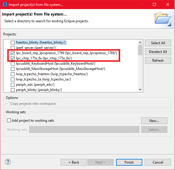

       4.   Select these two projects, and additionally select any examples you want to import:
And now you will be able to work with the LPCOpen examples.
