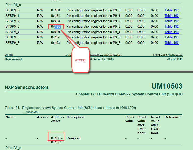

Using a LPC4357 I am trying to configure P9_3 to have MCOA0 function.
If I write to the configuration register 0x40086000+0x49C it seems to have no effect I read back all zeros, but if I do the same for another pin (0x40086494) the change takes effect and I read back the correct value.
What can cause this behavior?

    I check it again, I have found the address for SFSP9_3 is 0x40086000+0X48C, not like the document mentioned 0X49C, actually 0X49C is reserved:

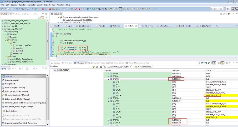

   I have do the testing on my MCB1758 with LPCXpresso IDE, the debug interface also shows the address for P9_3 is 0x4008648c.
    So, please change the P9_3 address to 0x4008648c.

     I think your problem is caused by the LPC4357 user manual error.
   I will report this document to our according department immediately, the problem will be fixed in the next doc reversion.

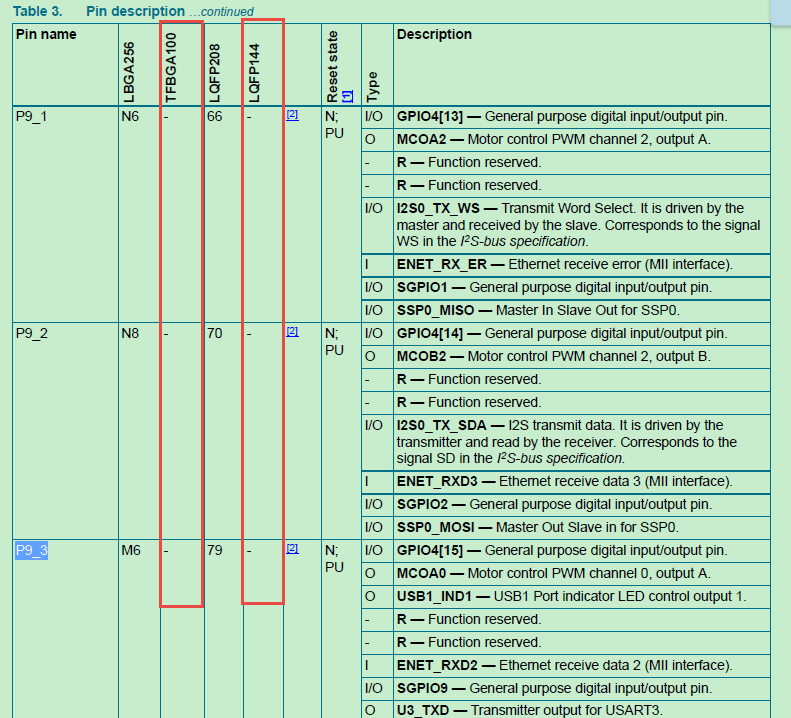

    Please check your LPC4357 part number at first, TFBGA100 and LQFP144 package don't have P9_3, so please make sure your chip have p9_3.
0x40086494 is P9_5, LQFP144 have this pin, so please check your package, are you using LQFP144?
