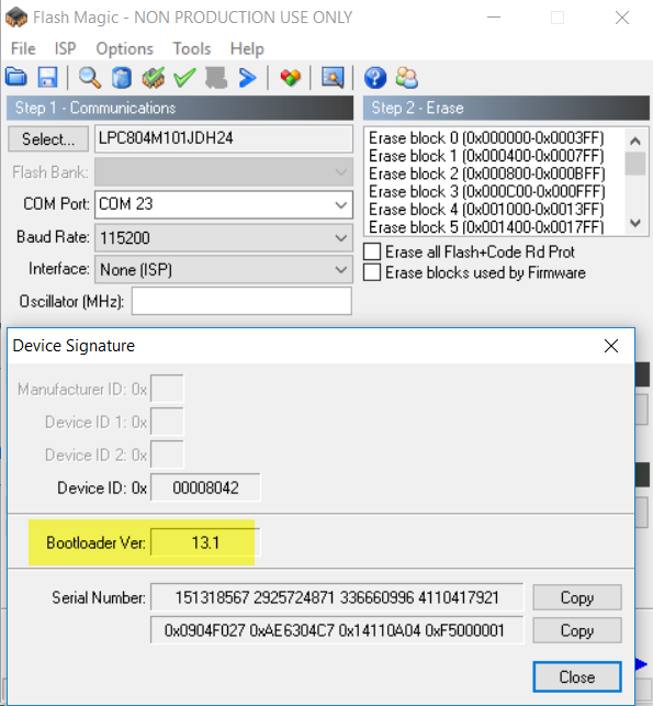

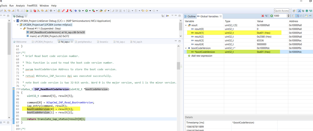

Hello  Robert Beekmans ,
The User Manual LPC804 rev 1.3 is right,
Boot code version has 2 bytes , Read as <byte1(Major)>.<byte0(Minor)>.
So in the  SDKv2.6, when read boot code version, you only need to read
bootCodeVersion[0] = result[1];
I also test on my side:
IAP read boot code version:
ISP read Boot code version:
Hope it helps,
TIC

roberto74
Hi Alice,
Thank you for your answer and I can confirm my LPC804 device also returns 0xD01 so as you stated the User Manual rev. 1.3 and LPC804 Example Code Bundle v1.6 are correct.
Hopefully you can confirm the API description of IAP_ReadBootCodeVersion(uint32_t *bootCodeVersion)
will be fixed in the next release of the SDK so it will not confuse others as well?
