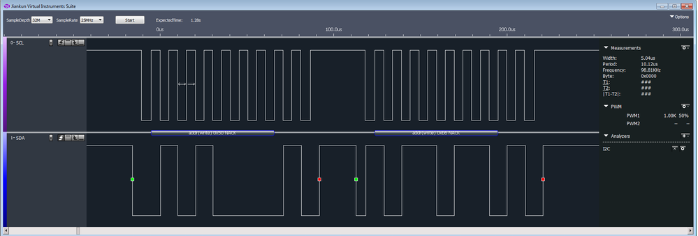

On Oscyloscope I can see that on both pins I means pin0_4 and pin0_5 are in high state. There is no CLK and Data signal at all.

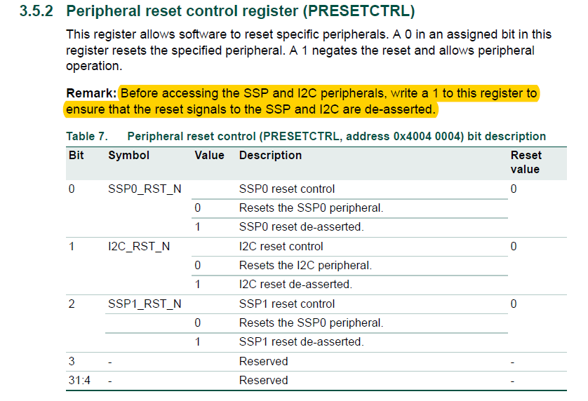

    Do you write a 1 to PRESETCTRL register before you access I2C peripherals?
   If not, please add this code before you initialize the I2C module:
Chip_SYSCTL_DeassertPeriphReset(RESET_I2C0); //before accessing the I2C peripherals, ensure the reset signal to the I2C are deasserted.
I have test our lpcopen code for LPC1347, it also lack this code, after add the above code, I can make it works, I checked the I2C bus on my side, it already have the data, but I didn't add the slaver, so I2C will have NACK.
  I attached the lpcopen I2C code which works in my side.
This is the I2C bus wave:
