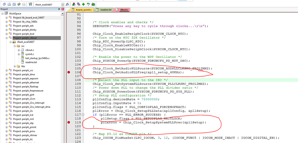

I have been going thru the various test programs for the LPC54608Expresso board and I'm having some problems with the "periph_clkout" sample. I can get the CLKOUT working fine, but only if I disable the PLL code (both system and audio).
If any of the Chip_Clock_SetAudioPLLFreq() or Chip_Clock_SetupSystemPLLPrec() is called (the two lines with the breakpoints in the attached screendump, the code will hang forever waiting for PLL lock (both Audio and System)
Am I doing something wrong, or are any of you able to reproduce this ?

Look in the board support project for "board.h"
Look for"
#define BOARD_MAINCLOCKRATE
Is it set to 96MHz?       Change it to something higher (180000000) .  The worked for me.

Thanks Eli,
I tried that also, but no success! I also did see that the project was set to LPC54113 as target, that was also changed, but no success.
What I did instead was to take the sysinit_lpc5460x.c from ARM\Pack\Keil\LPC54000_DFP\2.2.0\LPCOpen\lpc5460x\chip_5460x\src
and tweak that, and this worked. I have not looked into what the difference is, it might be that I was tricked somehow :smileywink:
Anyway, I got the chip running at 180 MHz (even tried 200 MHz for a few minutes which ran ok, but is of course out of spec!).
Eli, what speed do you run the SDRAM at ? It seems that 75 MHz is the maximum I can get it running at, if I go above 150 MHz clock, I need to do a  divide by 3 to the EMC controller. At 150 MHz it runs fine with divide by 2 (75 MHz) ??
