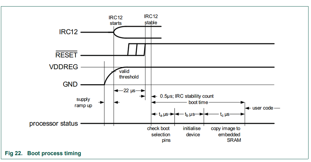

The datasheet for LPC4367 recommends tying VDDREG and VDDIO pins to ensure same ramp-up time. Is there any recommended value for the ramp-up time? Also, do the other power-domains like the RTC domain, USB power domain require any power sequencing.

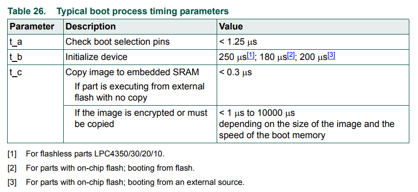

Please check the user manual for boot process timing (pages 66,67)
https://www.nxp.com/docs/en/user-guide/UM10503.pdf

My question was regarding the supply ramp-up time and the power sequencing mechanism of LPC4367. I have referred the pages 66 and 67 of UM10503. This document doesn't mention any recommended time for supply ramp-up. Is there a recommended time which is required for the supply to ramp-up?
