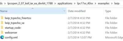

Hello @aus_swsol
You can directly download LPCopen for Keil, which includes a TCP demo within it.
Alice
