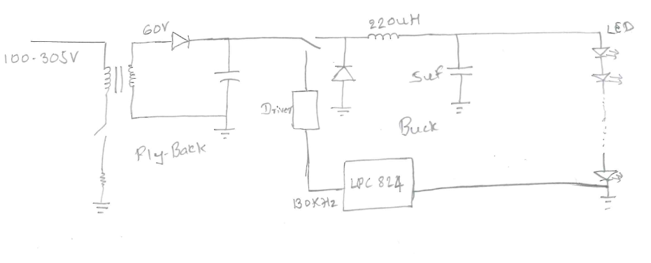

i am working on LED 40W driver with Fly-back followed by Digital Buck topology.
Operating output Current - 300mA to 1050mA
Operating output Voltage- 28V to 54V

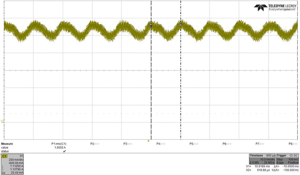

i am finding 100Hz ripple contents at the LED output.
Buck current ADC conversation triggered with PWM. Every 7.69uS ADC will be sampled and 8 sample average will be calculated. Further moving average calculation of 13 samples will be done using 8 samples averaged value.
PID sampling time: 200uS
PID processing time: ~50-60uS
Can any one help me how to remove the 100Hz contents at LED output?
I attached High level circuit diagram, output current waveform and PID code.
