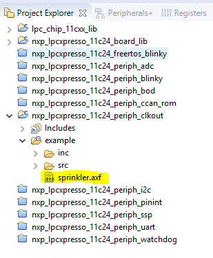

I managed to flash the new demo in the LPCXpresso54608. When you download the files from the next page https://touchgfx.com/nxp-semiconductors/lpc5460x/ you have a .axf file I convert this file to .hex with the help of MCUXpresso. To do this please copy the .axf file into any workspace that you have open

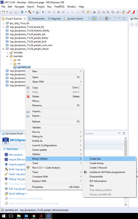

Then right click on the file > binary utilities > create hex
Once you have the .hex file of the demo you can follow the steps of the guide attach.
You can follow this steps for the moment. Meanwhile I will see if it's possible to upload to our page the files of the old demo.
