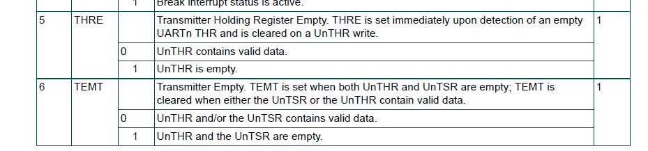

Hi, Vijay,
I suppose that you have configured the IOCON_P5_4 register to select the pin as U4_TxD correctly,  pls check if you clear the SCIEN bit in SCICTRL register, clear the IRDAEN in ICR register.
If you write the char to THR register and check the THREbit  in LSR register, can the bit be set or not?
If it can be set, it means that the data has been transmitted to pin.
