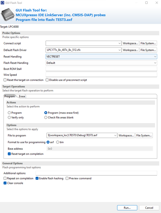

I am trying to use the MCUXpresso GUI Flash Tool to program a LPC4088 chip with my own code. On the board, there exists an external flash drive of 4MB and I am using the NXP LINK2 CMSIS-DAP debug probe. You can find screenshot of the settings that I have:
Now, when I press the run on the flash tool, I get the following error:

Loading 'TEST3.axf' ELF 0x28000000 len 0x15A1B8
File 'TEST3.axf' load failure: Ef(11). No flash configured.
Loading 'TEST3.axf' ELF 0x28200000 len 0x18F290
(100) Target Connection Failed
Unable to perform operation!
Command failed with exit code 1
I would appreciate any help.

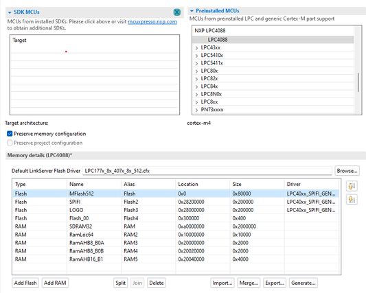

So do you want to download image to internal  flash or external flash?
And how about first test a simple project to confirm the hardware is no problem.
Alice
3,367 Views
bamdadslr
Hi Alice_Yang,
Thank you for your response. I want to download it to the external flash. From the console message that I attached to my first message, it seems that the internal flash could be successfully programmed, but not the external one. Is there any sample project for LPC4088 that I can try to verify the hardware is working and see how to manage it?
Thanks.
3,353 Views

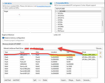

From your screenshot, it seems you use both internal and external flash, I don't think the IDE can download both flash at the same time. How about create a project only use external flash, and use  flash driver "LPC40xx_SPIFI_GENERIC.cfx" do download, also delete the internal flash:
There is demo under LPCopen, while they all use internal flash, you can change base on them.
Alice
