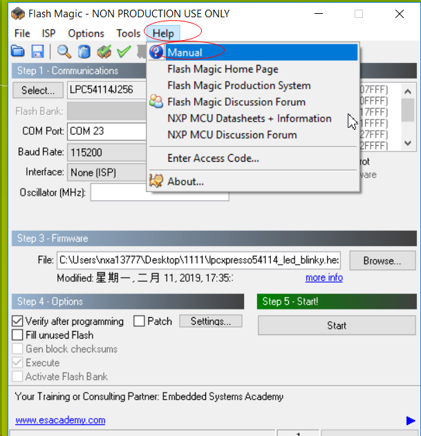

4.  - The Flash Magic just a tool to flash application image  to chip. It is not developed by NXP, there is more information
in the Flash Magic website Flash Magic - Welcome , also after you install it, you can find user manual  in "Help"
This is the same function with your bootloader, there is bootloader code in ROM ( AN12037), when enter in ISP mode ,
we can use the Flash Magic communicate with Bootloader, then send hex file , flash it. About how to enter ISP mode,
please have a look at the boar user manual.

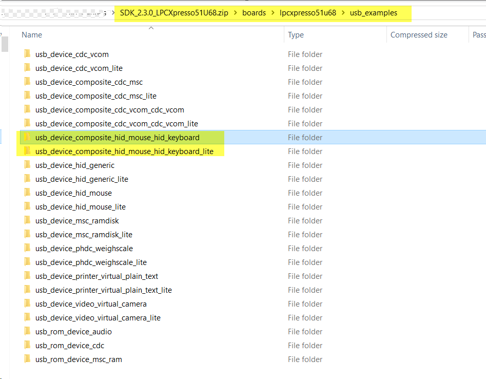

1. After download SDK for lpc51u68, you can find some USB examples, maybe this one named
"lpcxpresso51u68_dev_composite_hid_mouse_hid_keyboard_bm" can help you:
2. You only need MCUXpresso IDE and SDK .
3. About flash new image , you can use "Flash Magic" tool when chip enter into ISP mode, about the detail please
refer to LPC51u68 User Manual  about the part "Chapter 3: LPC51U68 Boot process".
Download Flash Magic at http://www.flashmagictool.com/

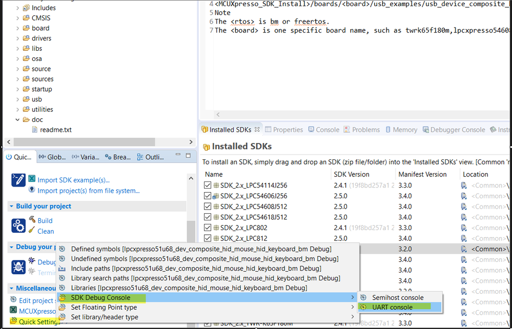

4. About " all example code" , could you please tell me which example. For SDK examples,  after open it on
MCUXpresso IDE, please set SDK Debug Console to UART console, the UART will work.
