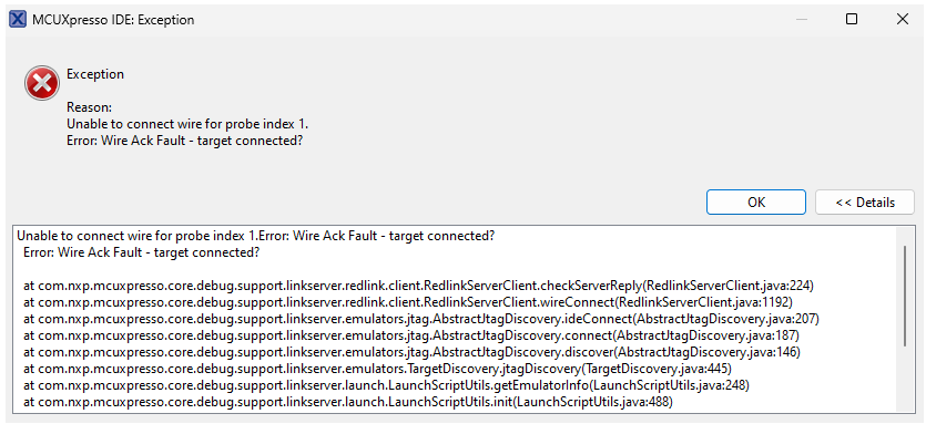

New development board ( LPCXpresso55S16 ) connected to J1 and gives the following error on debug mode. The example program being used is blinky.

Hi Xiang, Thank you for your prompt feedback.
I did exactly as per your instructions but still running into the same issue.
Resetting the board by pressing "SW4" did not help. I also deleted the old launch file but did not help.
Here is step by step process attached.
I hope you can help me analyze the error.

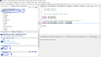

On the MCUXpresso IDE, pls as the following procedure to download code to flash
1)click the project to select it
2)click "Build" to compile/link the project
3)click "Debug" to download code
If you still have issue, pls press SW4 button, then insert USB cable to J1, then release SW4, try to have a "Debug" .

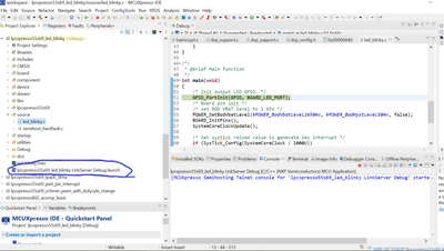

or delete the "*.launch", try to click "Debug"
