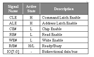

The External memory controller section in LPC4367's datasheet specifies only SRAM, ROM, NOR flash and SDRAM devices to be connected to the EMC.
However, is there any way to interface a NAND Flash to LPC4367 having the following interface?
Thanks and Regards,
Akhilesh Sreedharan
