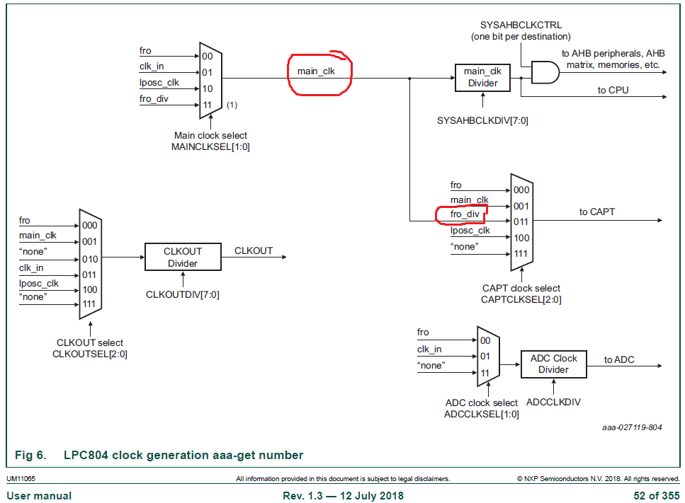

Hello there,
I found small mistake in LPC804 Users manual v1.3 - 12.July 2018 (https://www.nxp.com/webapp/Download?colCode=UM11065 )
On page 52, fig 6 - signal "main_clk" from MAINCLKSEL register is connected to input "fro_div" on register CAPTCLKSEL.
Please, correct it.

Thank you for your feedback. I will to report this to our documentation team.
