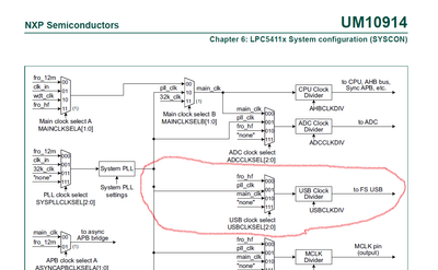

If you want to usb port for LPC54114, you have to enable the usb clock.
1)pls use the code to enable usb clock
SYSCON->AHBCLKCTRL1|=1<<25;
2)you have to set up the USB clock to be 48Mhz before you call the usb code in ROM
Pls have a check.
