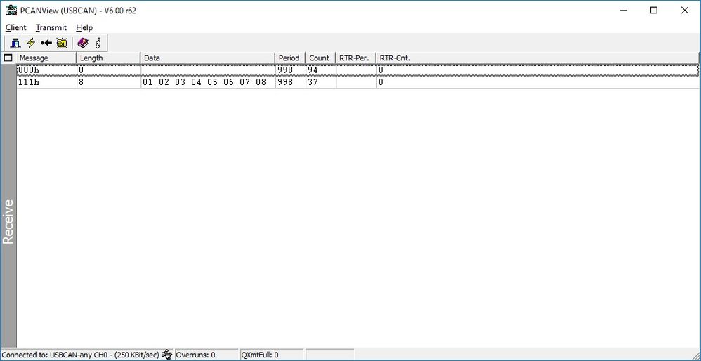

Does someone have experience with setting up the CAN controller on the LPC54608?
I have troubles initializing the message ram. When I declare the variable (Keil MDK):
uint8_t can_msg_ram_base[128] __attribute__((at (0x20010000)));
...and provide the message ram to the CAN controller like this:
MCAN_SetMsgRAMBase(CAN0, (uint32_t)can_msg_ram_base);
...messages are sent on the CAN bus (see the screenshot, message ID 111h).
However, if I declare the can_msg_ram_base variable on any other address, messages are sent with all zeroes (see first line in screenshot).
Are there any restrictions on the message ram location? The user manual does not specify such restrictions, other than it must be located in internal SRAM. I don't see why I can't put the message ram on an arbitrary location. I also tried  to align this arbitrary location on a 4/8/16-byte boundary, but that does not help. Can someone provide me with more information on the the restrictions for the message ram of the CAN controller(s)?

If I use 0x20010000 as the base address it works, if I declare my own buffer for this it fails. Have you measure on the physical can bus with a scope ? I did also receive all 0's in my PCAN-View but when looking at the bus there were only some sync data sent so I think that PCAN does not quite understand this and shows it as a frame with all 0 in it.
When changing address to the same as the example in the SDK it magically works for me!
(and yes, all my SRAM blocks are powered up and enabled)

Thanks a lot! Confirmed your finding, have reported to the design team to look into that.
6,679 Views
Dezheng_Tang
Casten,
    Sorry that I am not able to get back you sooner on this. The design engineer was not available in the last few days, and today, we start debugging this together. Here is my finding and I am still waiting for design to get back to me on this.
    You should be able to use all these memory region below for MCAN data communication:
//uint8_t MCAN_Memory[2048] __attribute__((at (0x20010000))); // OK
//uint8_t MCAN_Memory[2048] __attribute__((at (0x20018000))); // NOT OK
//uint8_t MCAN_Memory[2048] __attribute__((at (0x20020000))); // OK
//uint8_t MCAN_Memory[2048] __attribute__((at (0x20021000))); // NOT OK
//uint8_t MCAN_Memory[2048] __attribute__((at (0x20022000))); // NOT OK
//uint8_t MCAN_Memory[2048] __attribute__((at (0x04000000))); // OK
//uint8_t MCAN_Memory[2048] __attribute__((at (0x04001000))); // NOT OK
//uint8_t MCAN_Memory[2048] __attribute__((at (0x04002000))); // NOT OK
//uint8_t MCAN_Memory[2048] __attribute__((at (0x04003000))); // NOT OK
However, if you use 0x2001x000, the base address in MRBA register needs to be 0x20010000.
if you use 0x2002x000, the base address in MRBA register needs to be 0x20020000.
if you use 0x0400x000, the base address in MRBA register needs to be 0x04000000.
"x" above could be any value.
The base address need to be at the 0x10000 boundary or MCAN message receive won't work.
So, inside SDK, change
#define CAN_MRBA_BA_MASK                         (0xFFFFFFFFU)
to
#define CAN_MRBA_BA_MASK                         (0xFFFF0000U)
Please try it again and post your results here.
Once it's confirmed by the H/W design team, we will update the Users Manual as well as SDK software.
Thanks!
