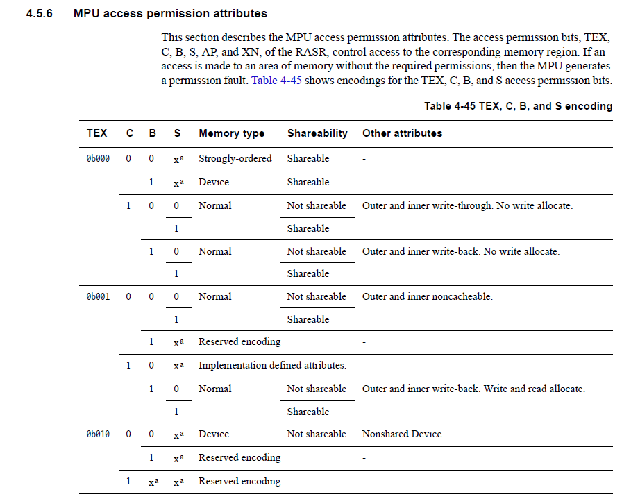

As you know that the MPU part is feature of Cortex-M4 core, the description of TEX/C/B/S bits in RASR register in the Cortex-M4 Generic User Guide is simple, there is only a table as following figure.
I suggest you ask the ARM support so that they can give accurate, clear  and detailed inf.

On top of that, Table B3-13 in the Architecture Reference Manual although captures the same information as Table 4-45 in the Generic User Guide, to my opinion it is more helpful to choose the appropriate TEX, C and B values: first you should choose the type of memory from the "Description" column, and then use the TEX, C and B values from same row when programming MPU_RASR.
Please note that the shareability attribute and the type of memory you should be using for your ROM depends entirely on your application and on the system which the Cortex-M4 has been integrated in, and therefore I am afraid it falls under the jurisdiction of NXP's customer support.

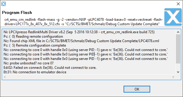

How can I determine TEX, C, B and S values for LPC4078?
I tried it with TEX=0, B=0, C=1, S=1, but unfortunately I can't access any more with my LPC-Link2-Debugger to the device. Maybe ISP-commands will awake it but that's more complex. I don't want to produce a bunch of bricks :-)
With the brick I only get "Could not connect to core" although electrical connection is fine:
Of course I've got other new devices which work but it's not my goal to damage them all.
