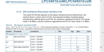

I am working with LPC54S018 EVK and want to generate maximum SPI clock frequency. Below are my observations:-
1. Getting 12MHz clock inspite of attaching HF clock (kFRO_HF_to_FLEXCOMM9). No effect of increased baud rate. (All the SPI pins are connected)
2. Getting 48MHz clock when kFRO_HF_to_FLEXCOMM9 is used and baud rate is set to 48MHz. In this case, only SCLK is connected, other SPI pins are not connected.
Let me know how can I generate maximum SPI clock o/p frequency? Can I use FLEXCOMM0-9 to generate maximum SPI clock o/p? (FLEXCOMM10 is not available on EVK)
Also suggest what changes are required to generate max SPI clock o/p frequency?

Regarding the maximum SPI clock frequency of LPC54S018, pls refer to the data sheet of LPC54S018, the master mode, the SPI baud rate is 48M bit/s, in slave mode, the baud rate is 14M bit/s.
Assume that you want to get 48MHz for SCK signal, If you use the code  kFRO_HF_to_FLEXCOMM9, the SPI drivig clock will be 48MHz.
and you have to set up the SPI baud rate by writing the SPI divider regisyter as 0, the SPI_SCK clock frequency will be 48MHz.
Hope it can help you
