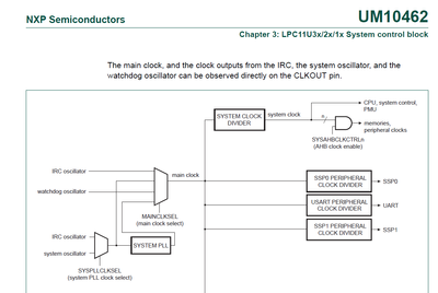

xiangjun_rong
As the following Figure, the CT32 and CT16 modules all use the PCLK(Peripheral clock), in other words, it is the system clock, pls check your system clock frequency.
