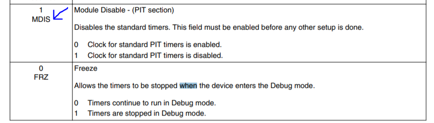

We are using Periodic Interrupt Timer in MKE04Z8VTG4 controller. While using PIT, facing a problem like, generating interrupt without reaching count to zero. Initializations are provided below:
 void pit_init()
CLOCK_EnableClock(kCLOCK_Pit0);
PIT->MCR = 0x01; // Enable clock for PIT
PIT->CHANNEL[0].LDVAL = 0x0003A9A6;
PIT->CHANNEL[0].TCTRL = 0x03; // Start Timer & Interrupt Enable
NVIC_EnableIRQ(PIT_CH0_IRQn);
NVIC_SetPriority(PIT_CH0_IRQn,0);

I have done the same thing sir.
but entering into PIT Handler even if counter is not set to zero.
Even the timing is also getting mismatch. from below calculation it should be 10msec, but it is set to 13msec.
Here BUS_CLOCK = 24MHz, PIT_INT = 10msec

Hi Muralidhar M,
In the MCR register, the first bit that should be enabled is the MDIS.
Also, I will suggest to start the timer after the NVIC interruptions are enabled.
I hope this helps you.
