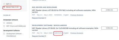

Yes, good. sw672318\Examples\NfcrdlibEx10_MIFAREDESFire_EVx is helpful to you. But this example is available under an active NDA, if you've already had an NDA, please log in NFC Reader Library | NXP Semiconductors to download sw672318.
