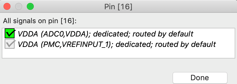

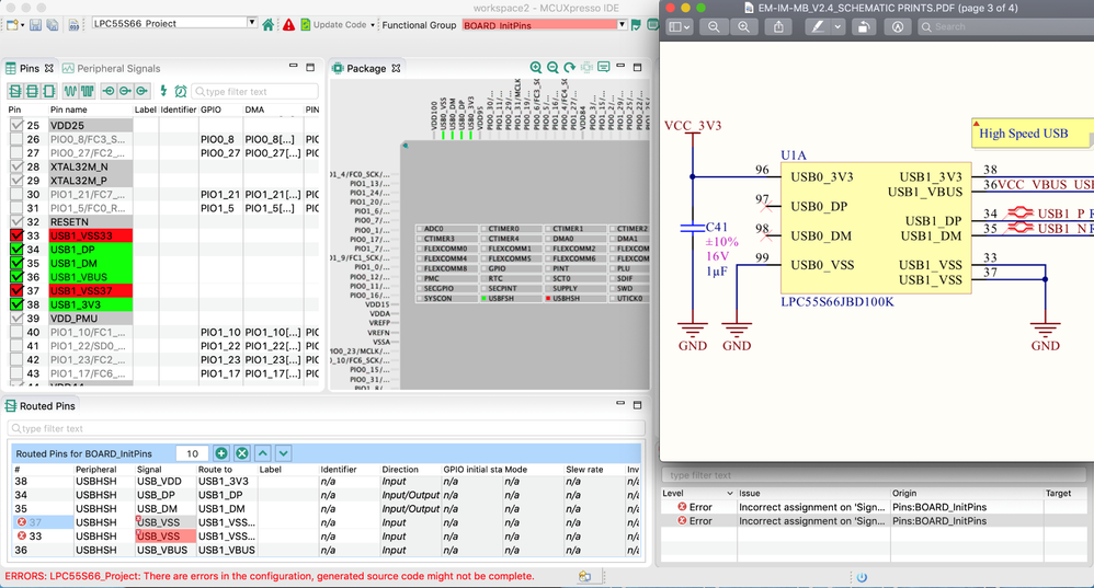

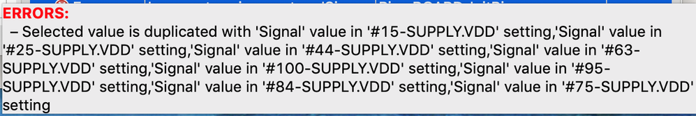

Hi NXP Team,
I am Newbie to MCUxpresso and trying to configure pins as per schematics but getting below errors
Any suggestion on these errors.

Hi Hemelatha,
You dont need to route those power supply pins; it looks we have a bug here whereby the tool is seeing the 2 USB grounds as conflicting (same function on the USB peripheral) due to a problem in the product definition files. If you just unroute the USB1_VSS pins then the problem should go away (it does for me). To unroute just right click on the pin name in the Pin name column of pins pane and select "Unroute".
We'll look at fixing the problem but you should be able to workaround - none of the automatically routed pins need to be configured in the tools.
