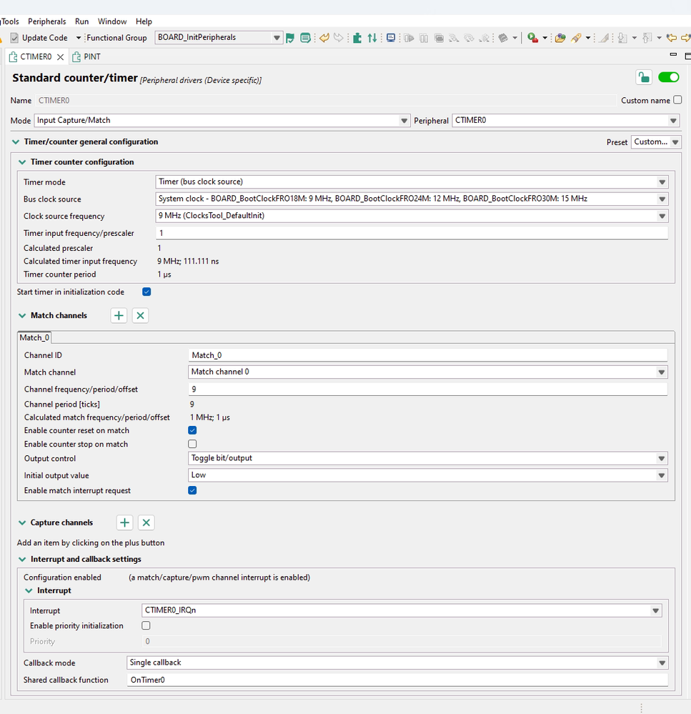

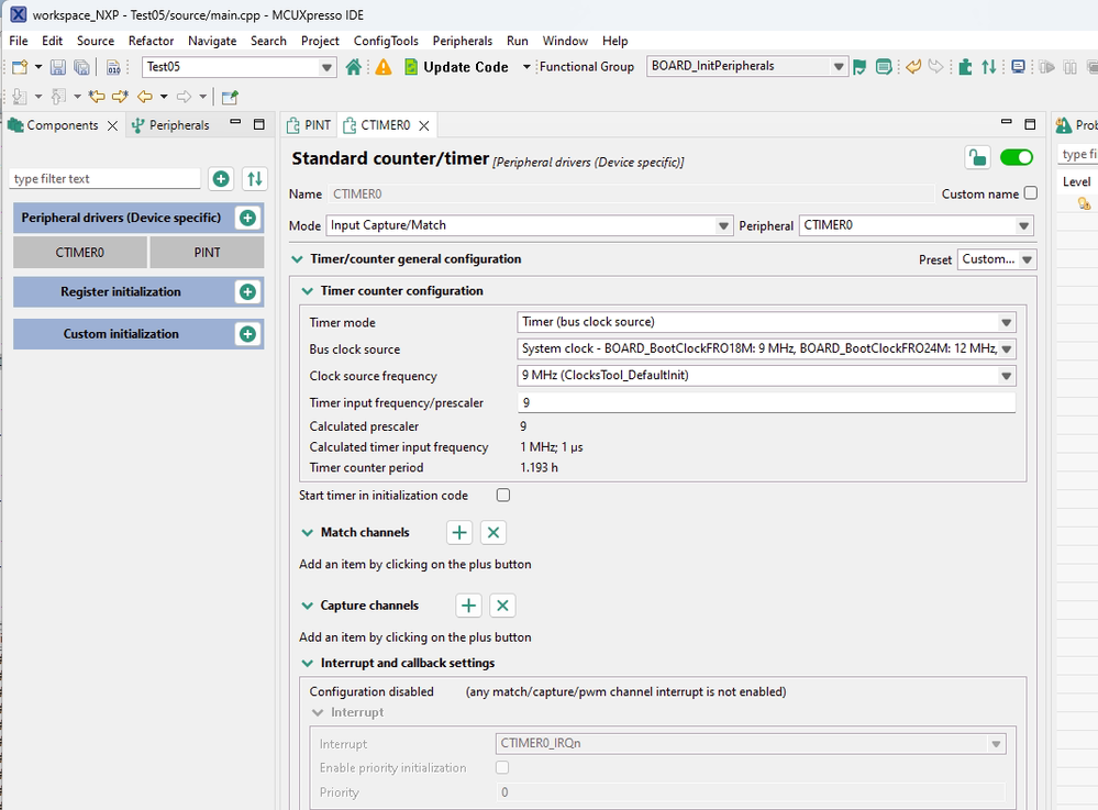

Hi, I'm trying to setup a timer in MCUXPresso with lpc804 mcu.
I have configured the timer as below. How can I define a callback to trigger on timer?
