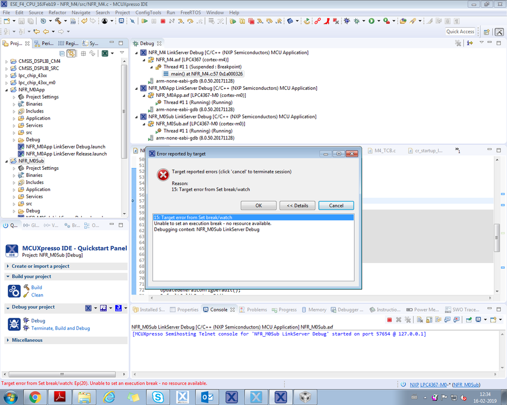

gauravmore
Hi Jeremy,
Thanks for the quick response. I m using MCU Expresso Ver 10.2.1_795. While launching the multi core project i am getting follwing error
Whic is comming wheni am debugging M0App . I am not able to get the actual issue. only once it was able to launch all the cores properly. Same when i am doing with LPCxpresso 8.2.2 it is working fine and proper.
Another observation is that when i restart the PC and reload the new project it is getting reloaded and able to debug properly . Then i terminate the debugging session and then again tried to relaunch the debug session. Then i found that i was able to launch M4 and M0App but when it comes to M0Sub follwing is the error pop out
Please let me know what is the resaon. This is happeing with MCU xpresso 10.201_795 version consistently. To conclude it launch the debugging session only for the first time and for the next time it fails.
Please let me know of any moficiation required in my project whihc i may be missing.
Gaurav More
9,194 Views
vicentegomez
Usually, when working with two cores projects, the debugger doesn’t exit correctly the debug session and before connecting again to other debug session it needs to have a known state. Disconnecting the device and holding the ISP button before connecting it again should do the work.
Hope this will help you.
Vicente Gomez
9,194 Views
gauravmore
Hi Vicente,
The issue is resolved. I had a discussion with the technical team of NXP from banglore and get itresolved on my Development board as well.
The issue was
1. I was able to launch two cores but when i was trying to download 3rd core it as giving me error. So the solution i got from the team is to run it then it will be in reset ISR and then select the project and click on terminate and relaunch then worked properly. the reason is the same that ou mentioned in you post.
2. Other issue as that i also created the project at my end and tried to debug the same way mentioned by the team. There i was able to launch all three cores but the when i tried to relaunch them after terminating then it was giving flash driver failed error. After discussion with the team , got to know theat ther is mistake in the memory configuration that i had done in my project where i was selecting wrong .cfx file for M0app. after modifying it and changing the memory sequencing it worked.
reagrding the second issue this was not the case in LPCXpresso it it only reagrding the MCU Xpresso.
So now i am evaluating the code but the reagarding the 1st issue i was informed that since the IDE (MCUXpresso) is license free there are cerain things we need to take care, So reagrding that i need to know that whether there any new updated version of MCUXpresso geting launched?
Please clarify this.

jeremyzhou
Hi Gaurav More,
Thanks for your reply.
Actually, I also have no idea with it now.
Maybe you can give a try to clean all projects, then recompile them to eliminate the error.
