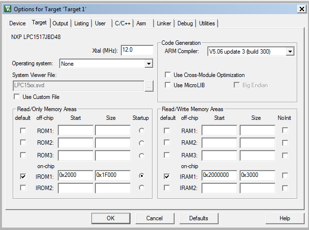

I am working on LPC1517.
I am using uvision5.
I builded my program code and i got my hex file without error.
But when i programmed my lpc1517 with this version,  it does not start!!!

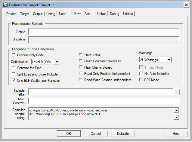

If i remove one line code ex: i++; and i rebuild it .. it is working!!! But i need to add some functions but i can't!!!
It likes i reached a limit but my flash has 256KB and my code takes only 60KB.
I had enough space of ram too.
And i can use only Level 0 (the program is not working if i use the other other level??)
Which is my problem?? (i attached my map file just in case)

Do you have uvision5 evaluation version?
Keil development development tools without a current product license run as a Lite/Evaluation edition and have the following restrictions:
MDK-ARM Lite Edition
  • Programs that generate more than 32 Kbytes of code and data will not compile, assemble, or link.
  • The debugger supports programs that are 32 Kbytes or smaller.
  • The compiler does not generate a disassembly listing of the machine code generated. The -S, --asm, and --interleave compiler command-line options are disabled. Projects will not compile with Target -> Listing -> C Compiler Listing enabled.
  • The compiler and assembler do not generate position-independent code or data. The --apcs /ropi /rwpi /pic/ pid compiler and assembler command line options are disabled.
  • The assembler and linker create Symbolic Output Format objects which cannot be linked with third-party linker utilities. Fully licensed tools generate standard ELF/DWARF files which may be used with third-party utilities.
