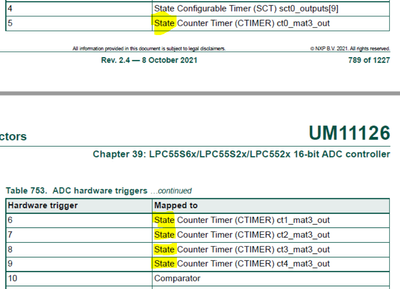

In table 753, it looks like CTIMERs are mistakenly called "State Counter Timers". Hardware trigger 11 is listed as "ARM tx event" but that's not defined anywhere that I can find. What is this interrupt? All Google results for "ARM_TXEV" come back to NXP docs and it's never described, as far as I can tell.

The error I'm referring to is here:
There is no "State Counter Timer". The SCT is the State Configurable Timer. The manual describes CTIMERs as "standard counter/timers" - they don't have "state" anywhere in the name.

xiangjun_rong
As the following Table 753 in UM11126.pdf ver2.4, the SCT(state configuration timer) is not CTimer, the SCT is an independent module which can generate complex PWM signal, of course, it can generate ADC triggering signal with constant cycle.
For detailed inf, pls refer to chapter Chapter 24: LPC55S6x/LPC55S2x/LPC552x SCTimer/PWM(SCT) in UM11126.pdf
