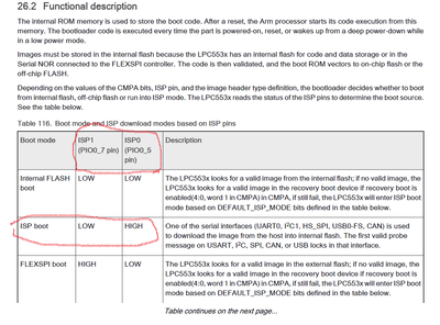

For the LPC5536, in order to enter ISP mode, you have to connect PIO0_7 to a pull-down resistor, connect PIO0_5 to a pull-up resistor, so the PIO0_7 will be low, PIO0_5 will be high after Reset, the LPC5536 will enter ISP mode, you can use blhost instruction to erase all flash.
Pls refer to section 26.2 Functional description  in LPC553xRM.pdf
BTW, there is not SWJ-DP/ITM pin for LPC5536, I suppose you refer to the other ARM family.
