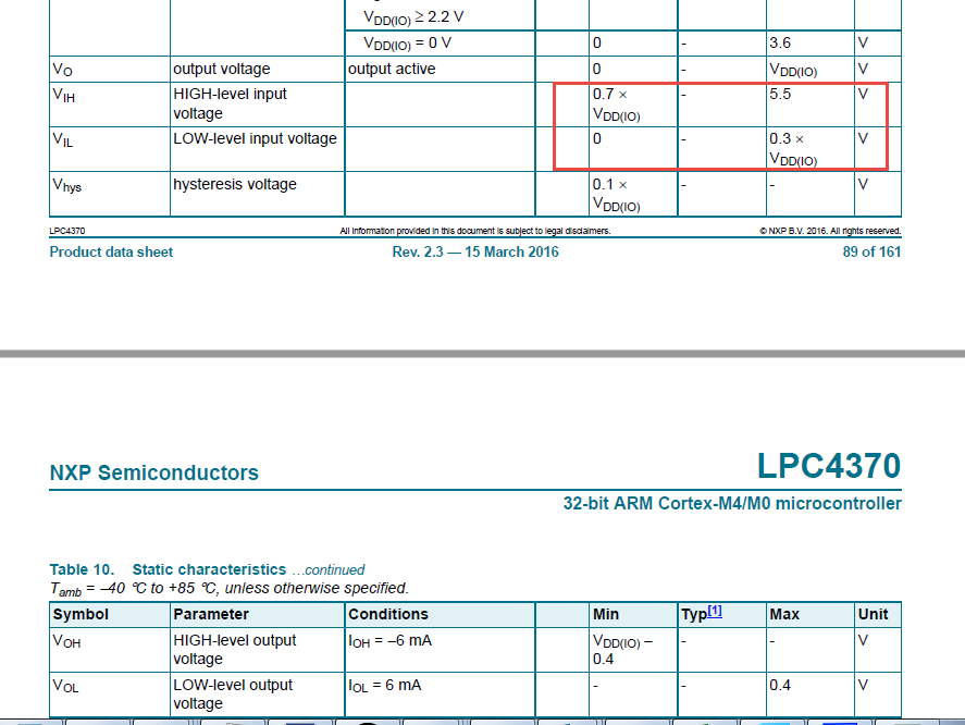

For Link2, there are SWCLK and SWDIO, what's the threshold for high and low?

Aren't the important lines SWCLK and SWDIO buffered by a 74LVC2T45 between the LPC4370 and the connector? So, for the levels, shouldn't you be reading the 74LVC2T45 datasheet, not the LPC4370 datasheet?
http://www.ti.com/lit/ds/symlink/sn74lvc2t45.pdf
Boards that refuse to program for no apparent reason are quite common.
If you want reliable programming insert a buffer (74HC1G17) in the SWCLK line on the target board.
See https://community.nxp.com/message/952947 for details of my findings.

   LPC-LINK2 chip is the LPC4370, so you can refer to the LPC4370 datasheet:
High: need to >=0.7*VDD
Low: need to <=0.3*VDD
Wish it helps you!
