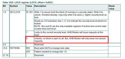

I was trying to exploit ECDSA sign/verify functions in secure memory, so I ported "lpcxpresso55s69_mbedtls_benchmark" project in SDK 2.12.0 to my TZ project.
I found that when I use those functions in applications in secure world, it was always stuck in 'hashcrypt_sha_finalize' or 'hashcrypt_sha_process_message_data'  functions, specifically in this while loop,
while (0U == (base->STATUS & HASHCRYPT_STATUS_DIGEST_MASK))
The status here was set to 5 when I tried in secure world, but it was 3 when I tried in normal work, where the code worked fine.
To clarify why this happens, I changed the MEMADDR where the message was given to any non-secure RAM and it worked well, which probably means that this is not the configuration issue, but the hardware/software bug using secure RAM.
//  base->MEMADDR = HASHCRYPT_MEMADDR_BASE(message);
    base->MEMADDR = 0x2001bd4c;
Would anybody help me to figure this out in more detail?

Hello @mat1024
How about add code
HASHCRYPT->LOCK = HASHCRYPT->LOCK | ((0x0A75<<4) | 0x1);
Because the HASH-AES engine is unlocked by default. That means it will issue non-secure requests as AHB master, as shown below.
So we cannot use it at secure state when it is unlocked. We must lock it at secure state if we want to use it at secure state.

mat1024
Hi @Alice_Yang ,
Thanks for your comment!
After adding code right next to resetting the peripheral in HASHCRYPT_Init() function, it works perfectly!
void HASHCRYPT_Init(HASHCRYPT_Type *base)
#if !(defined(FSL_SDK_DISABLE_DRIVER_CLOCK_CONTROL) && FSL_SDK_DISABLE_DRIVER_CLOCK_CONTROL)
    CLOCK_EnableClock(kCLOCK_HashCrypt);
#endif /* FSL_SDK_DISABLE_DRIVER_CLOCK_CONTROL */
    RESET_PeripheralReset(kHASHCRYPT_RST_SHIFT_RSTn);
	// From NXP forum
Hope this snippet of code would be helpful to those who want to use cryptographic functions in a secure world.
