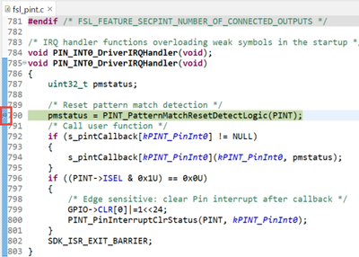

       Currently I am working on LPC804 controller. In that pin interrupt method only working in EDGE triggering. Level triggering method isn't working. I tried the LPCOpen demo code also. Kindly give some reference on this.

I tested your project with lpcxpresso804 board, the PINT with High level interrupt  works well.
You can set a breakpoint in PIN_INT0 interrupt function as below:
When input high level on pio0_13 pin, will enter this interrupt function.

                         I checked the demo code through MCU expresso IDE. In that I configured GPIO pin and all registers properly. still, Level triggering not working but edge triggering is working properly.

How do you test on LPCopen demo? How about change to another pin?
And please check all the related registers configured correctlly.
