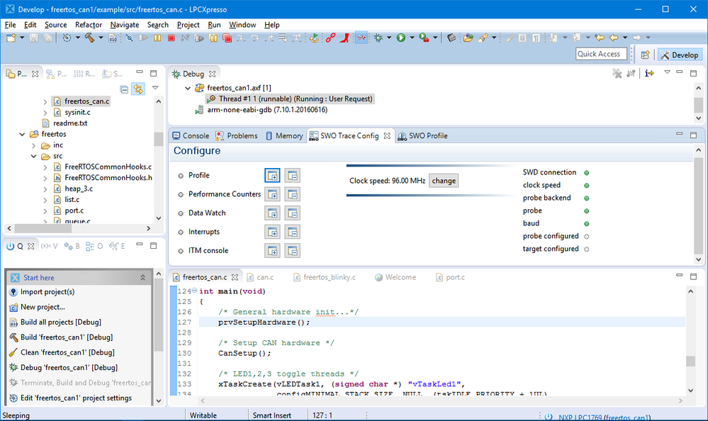

I have OM13085 board and LPCXpresso v8.2.2 on Win10.    I can build the example projects and load/debug code but the SWO features don't seem to work.   The SWO Trace Configuration shows green lights for SWD connection, clock speed, probe backend,  probe, baud.    The "probe configured" and "target configured"  indicators are NOT green.
I can load code and debug/single step but would like to use the SWO Trace features.    What can I do to get the SWO trace configured properly?

I'm afraid that the LPCXpresso1769/CD board's built in debug probe does not support SWO tracing - you need an LPC-Link2 to carry this out. For more details, please see https://community.nxp.com/thread/389084  along with the the trace guide supplied inside the LPCXpresso installation directory / built in help system.
