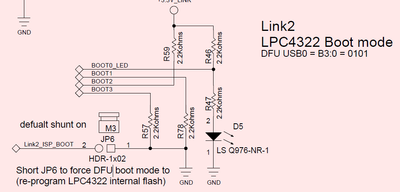

The board make DFU link and J5 USB connector.
No device were found in the device manager , and cannot be detected in debugger.
system: win11;  development board:LPC43S67

Hello, my name is Pavel, and I will be supporting your case, I review your case I do not if your problem is the debugger on the board or win11, the issues with win11 are not a priority.
Try with HOST DEVICE DRIVERS
LPCXpresso43S67 Development Board | NXP Semiconductors
Try too update the debugger on the board with J-link.
LPCScrypt v2.1.2 | NXP Semiconductors
LPC-Link2 Debug Probe Firmware Programming (nxp.com)

I installed the host driver and update the Jlink driver.
file1:  lpc_driver_setup.exe
file2: JLink_Windows_V788g_i386.exe
It doesn't work.

Hello, could you update the firmware of your debugger on the board?
You will need to put the board in DFU mode Device Firmware Update.
