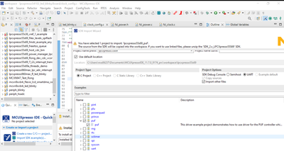

There is example of PUF in driver_examples group.
Hope it can help you
