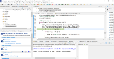

I have the LPCXpresso546xx/540xx board - with the LPC54018J CPU. I have been testing the samples available using MCUExpresso v11.2.1 for weeks/months now. Was even able to connect some RS232/SPI breakout boards on it.
However while testing the lpcxpresso54018_spifi_polling_transfer sample application, I can no longer debug and I'm getting this SPI flash error.
Sometimes I get EXTSPI driver rc 88.

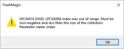

-  Flash Magic also giving me an very odd error.
It seems the External Flash cannot be overwritten anymore.
