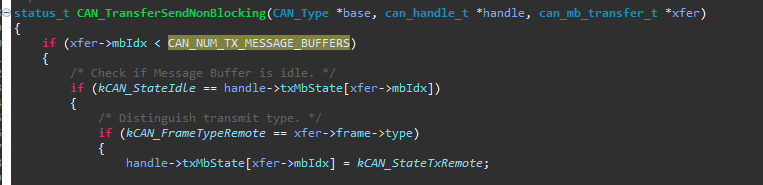

I have a question regarding the LPCXpresso 54628 in combination with the "Channel CAN FD" board.
I tried to integrate the sending of one message into a RTOS for cyclic message sending. Standalone everything worked. I tried to go through it step by step. In first cycle i goes through but no message is detected on bus. In second cycle the kstatus went to TxBusy everytime. How can i release this again or know how to setup? I tried,  Non-blocking, no callback; Non-blocking with callback and Blocking sending functions. But no message on bus detected. Attached is my project. As a bus sniffer i have a Raspi+shield.
Passage -> always busy
I still do not know why there is no message on the bus. Maybe one of you experts can support me - kindly asked
Thanks!
Nils

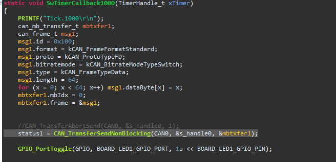

Neolinga
Hello XiangJun Rong,
thank you for the hint. Yes i also tried this without step by step and with Breakpoints after and before. Also without any Debugbreak.
My SW timers are working fine, but the sending process is not happening. This is my SWtimer in 1000ms cycle. Above is the program i used but i am still working continously on it.

Neolinga
yes i have a general CAN-FD sniffer connected to the CAN sending port. Baudrate (Data and nominal) are matching. 2000000DBaud and 500000nominal Baud.
So CAN-FD is setup on both nodes. I have a sender (Just the LPC with trying to send one message in the SWtimer cycle) and one receiver -> sniffing toll with Rapsberry Pi and shield. Example is working with this setup fine. Also Resistors are applied. I guess i just miss some declarations in the programm itself. Setup should be fine.
