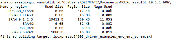

Hello I am very new at NXP community. I bought LPCXpresso54608 demoboard. I am trying to use BOARD_SDRAM via SDK but could not be successful or I am missing sth .
I do not know how to use external sdram with via example code. I dont know what I have to add. Is there anybody to help me about it ?
I used "SDK_2.2_LPCXpresso54608_OOBE\boards\lpcxpresso54608\driver_examples\emc\sdram" example downloaded from SDK for LPCXpresso54608 v2.2 .

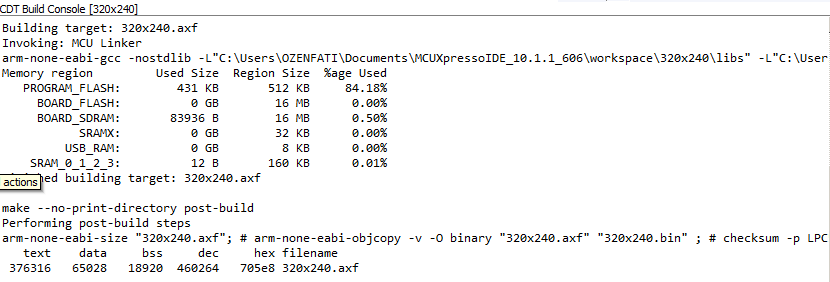

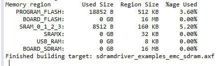

I looked at your examples and I could not see any usage of external Ram in both 2 bpp and 16 bpp projects. My project is emwin_touch_and_draw from SDK_2_3_0_LpcXpresso_54608. I modified it a bit as you see below. I used timer etc. and I modified the pin_mux.c file to use sdram and emwin library at the same time.
as you see I add there a header file " #include "cr_section_macros.h" " to use  this macro :                         __attribute__(( section(".noinit.$RAM4"), aligned(8) ))
my sdram is fourth one. when I make a new buffer and use it in 'int main()' I can see that I use an external sdram. That is okay. But I could not find framebuffer for emwin library. If I find it I can move lots of my datas to external ram.

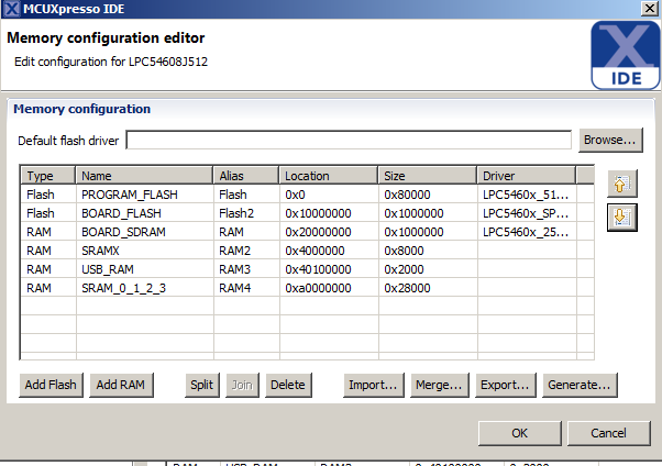

I have tried one more thing. I made my external ram's priority first from Project>Properties>C/C++ Build/MCU Settings.

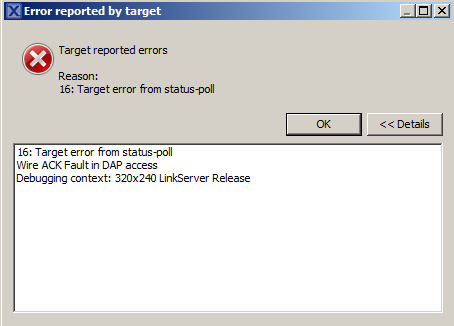

I changed its location with SRAM_0_1_2_3's location. I added its driver. when I compiled it there was no error and all datas was looked in BOARD_SDRAM.
But when I debug it, It gave an error as expected. Error picture is here. I don't know what to do on this step.

Next thing: your debug problem. In a first step it's not a debug problem, it's a setup problem.
Think about if the SDRAM is already up and running (= initialized) when the system tries to use it. With your linker map you instructed the linker to put all variables into the external SDRAM. This means that all variables right from the beginning of C code are located in external SDRAM. Again, are you sure that at this point in time the SDRAM is already initialized??

I think there is a problem on SDRAM initializing. I got en error when I want to debug the project :
"Debug port inaccessable after access at location 0xA0000000
Beside all I want to move all data to external sdram. I don't want any data in Flash and internal Sram.
I moved datas from flash to internal ram by activating Link application to RAM box. Project>Properties>C/C++ Build>Settings>Tool Settings>MCU Linker>Managed Linker Script.
5,537 Views
bernhardfink
To be honest with you, I think you're missing quite some fundamentals when it comes to microcontroller software design. Take a sheet of paper, sit down and try to reproduce what the ARM Cortex-M4 is doing when it catches the very first instruction from the reset handler, located in the Flash boot memory.
Try to find out what happens when, especially the relocation of code. For example if you want your object main.o, which is the compiled version of main.c, to be in SDRAM, try to see when this copy from flash to SDRAM is done and if at this point in time the SDRAM has alread been initialized.
Same story for the debugger: if you instruct the debugger to do something with the SDRAM, make sure that the SDRAM has already been initialized.
The following links contain some information about this:
Placing specific functions into RAM blocks
Relocating code from FLASH to RAM
Using your own linker scripts
There are many more papers when you search for keywords like "placing functions in RAM" or "relocate code into SDRAM"

Hi Fatih,
looks like your issue is actually one of knowing how to set up the linker to specify SDRAM. The SDK includes an example for use of the SDRAM, so I suggest you take a look at that... you can find it here: <INSTALL DIRECTORY>\boards\lpcxpresso54628\driver_examples\emc or just add the emc\sdram example using "Add example from SDK" in the Quickstart panel if using MCUXpresso IDE.
regards,
Brendon

brendonslade
Hi Fatih,
This app note / example shows how a frame buffer in SDRAM is used. Its built on SDK drivers ... maybe this can give you a few pointers to get started.
https://www.nxp.com/docs/en/application-note/TN00015.zip
As Bernhard states, my comments were a little misleading and his description is more accurate. The SDRAM example in the SDK is more about showing how to use the sdram/emc driver. The example in this app note is more about real usage of a buffer in that location. However, it is possible to use the SDRAM without it appearing in the output of your build; if you arent defining variables or executable code to be resident there.
regards
Brendon

bernhardfink
I didn't look into the example, but as it is an example for SDRAM, I assume it is used somehow. So my best guess is:
If you write program code, you can declare variables, arrays etc and let the linker allocate memory for it. In this example it seems that the first memory for the linker is the internal SRAM. In case the external SDRAM is available for the linker as allocatable memory, it would use it when it's running out of internal SRAM or if a structure is too big to fit into the (remaining) internal SRAM.
Most likley in this example a buffer structure (for example a display frame buffer) is hardcoded to be in external SDRAM, so it's not up to the linker to decide where to place the buffer, it has been decided by the programmer. In this case it does not appear in this linker memory map, simply because it has not been allocated by the linker.
But it will for sure appear in the overall map file as memory area in the external SDRAM
Bernhard.
