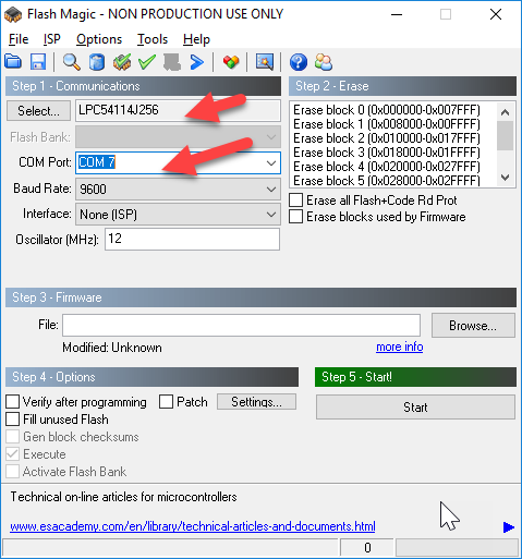

how to flash hex file LPCXpresso 54114 eval board, i'm trying flash hex file with "Flash magic Tool" getting some Error "auto Boud" can you help me any other open source flashing tool.

5. Open Flash magic Tool
6. Select the device and the COM port.

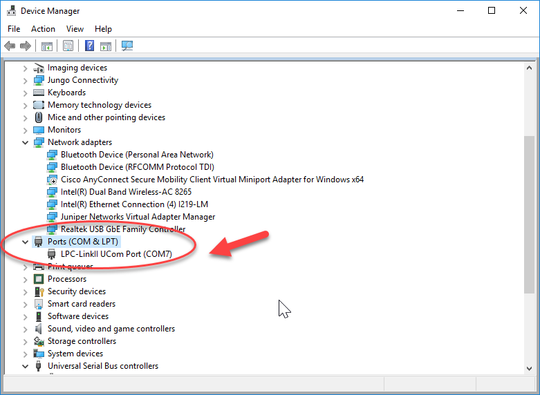

The COM Port depends on the Communications Port of your Computer's RS232. When you use this COM Port with FlashMagic – be sure that no other program is using it at this time.
You can check the COM port using the device manager >Ports (COM & LPT)

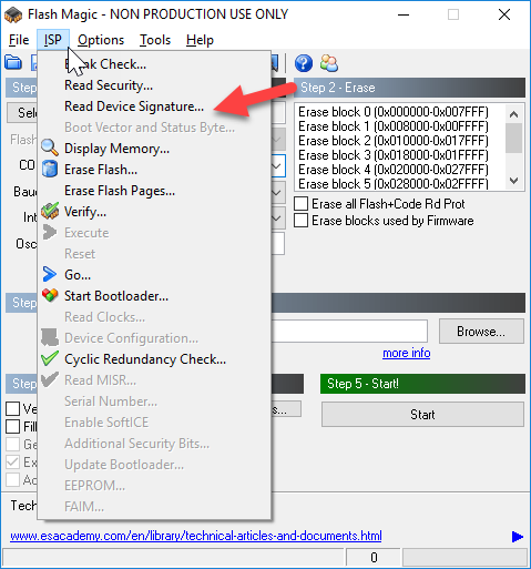

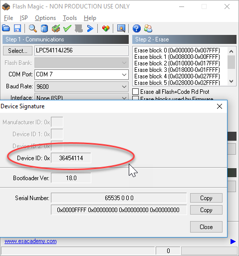

7. If you want to check if FlashMagic is working with your board use the "Read Device Signature" option:
If everything is ok you will see this window with your device ID on it.
