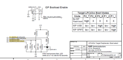

P2_7 is connected to the ISP switch (SW2)? No?

xiangjun_rong
Hi, Tim,
First of all, can you post the schematics of LPCXpresso4337 so that I can check the P2_7 pin switch or button.

Schematic can be found here

xiangjun_rong
I think it is a bit complicated that you want to use uart0 to boot up, you have to configure the board so that it can boot from uart0.
If you want to boot from uart0, all the P1_1/P1_2/P2_8/P2_9 must be low.
the P1_1-BOOT0_LED-SSP0_MISO must be LOW, you can close the pin 3 to pin5 of the J3 connector to make it low. You have to close the JP3 so that P2_8-BOOT2_TRGT is low.
Regarding the UART0 signal, if you J5 USB connector, the PC will enumerate the J5 USB as a CDC port and give a virtual port, you can use the port as UART0 to download code. If you do not connect the J5 USB connector, you have to connect the UART0 via  P4 connector.
After the above configuration, you can hold on the SW2 during the power power off then on, after a while, release SW2, then check if you can use FlashMagic to communicate with the LPC4337.

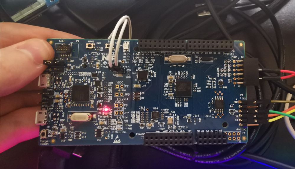

Thanks for taking the time to help but unfortunately still no luck, the PWR LED is active but the boot LED shows nothing and no response from FTDI UART. Using the USB no COM device is visible either.
This is my setup to confirm (With SW2 held on reset)

xiangjun_rong
Hi, Tim,
It is unusual that you can not see the CDC virtual COM port if you connect the link USB port.

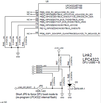

xiangjun_rong
On the LPCXpresso4337, if you open JP6 jumper, can you see the CDC USB port on the PC device manager?
XiangJun Rong
7,502 Views
emantec
Open? I assume you mean bridge, if I do that to force DFU mode then I can see a COM port in device manager.
Without bridging I only see the COM port when running the previously mentioned project.
