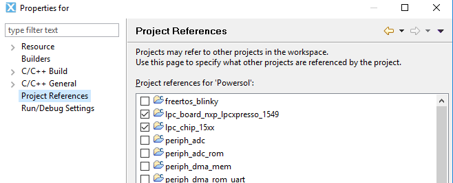

athmesh_n
For including a header to a file,
Go to: Project -> Properties ---> Select "Project Reference under the left tab", select the board and chip header files.LPC.png
