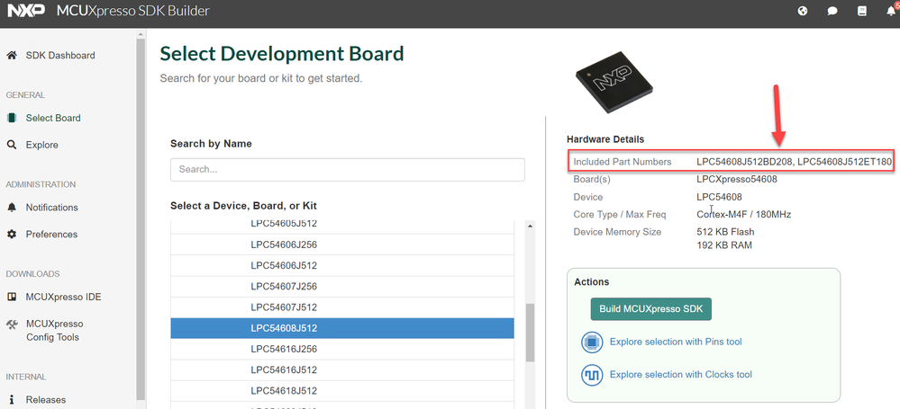

I'm working on the LPCX54608J512BD208 and I'm trying to handle a web page on it. I noticed that the examples from an SDK (lwip httpsrv) work only for the one who has 180 pins. Where can I get an example for my chip ?

The LPC54608 SDK includes the LPC54608J512BD208 and LPC54608J512ET180, so the example should work for your device.

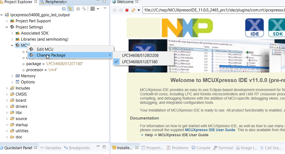

When I import the SDK example I can't change the package of the MCU :
I can only change the package when I start a new project (without an SDK examples). I already manage how to modify the web page with the file fsdata.c (cause it doesn't work if I only change the index.html), by the way, I must use a Hex To ASCII converter and it's not convenient, if you have a solution for that it'll be great. My only issue is to communicate between a web page and the micro controller. Do you have an example like a led controller from a web page ?

It is possible to change the MCU, please right click on MCU and select the device.
