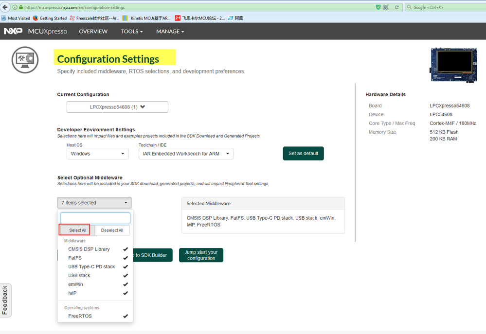

thank you for your answers. I downloaded the SDK 2.2 for LPC546xx, but i cannot find any support for USB or Ethernet. Does this mean, i have to add this by myself?

Hi Joachim,
   In the download link, please do the configuration like the following picture:
You need to select all in the optional middleware.Then generate the code and download it.
Please try it again.
